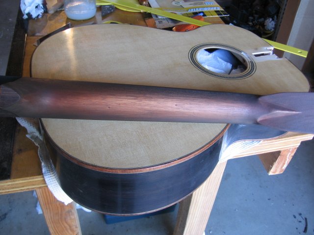

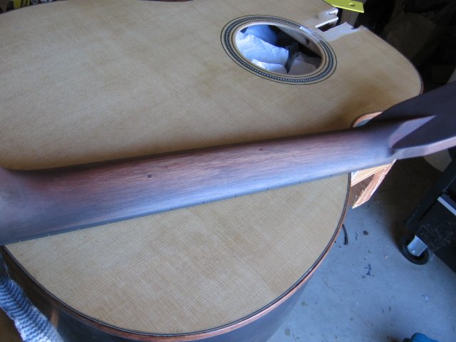

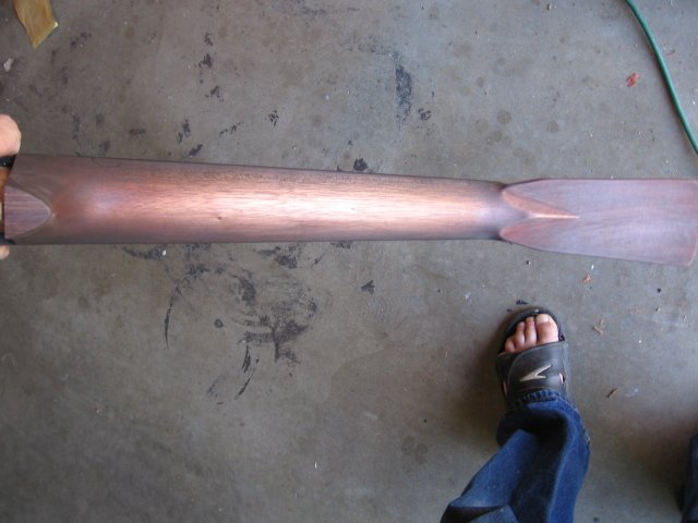

Thanks James those pics are really nice. I went with 3 colors of stain and feathered them in as best I could. I think it is going to look OK. I'm trying to upload some prelimnary pics.LarryH38760.7071412037
Thank You and Best To All
PostPosted: Sun Feb 12, 2006 9:10 am
Posts: 1624
First name: Larry
Last Name: Hawes
I tried Olympic oil based stians in Mahogany, Dark Ebony and Mocha Brown. Haven't sanded yet, just wiped and blended. Looks pretty cool. I'll put some finish on and check in again.
Larry
LarryH38760.7163425926
PostPosted: Sun Feb 12, 2006 10:27 am
Larry, your choice of footwear frightens me, y'know.
If you're just finishing, yeah. If you're doing ANYTHING else, wear proper footwear. Seriously, don't ask me how I know this....

The neck looks fine. I think it will look great when you put the clear on it.
